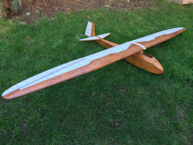

I did almost this on my Ka1, but smaller model, so I used 0.4mm plywood, but I covered it in 1mm balsa first:
Now, Joe did his Grunau all in Balsa, varnished, and I have to say, the finish is fantastic! But he is much better at it than me!
