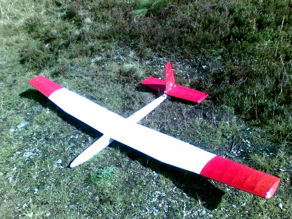

long before i understood slope soaring i bought a reasonably cheap glider , called a protec malibu. as you can imagine it didnt spend long in the air, first time out i broke the fuz but the wings were ok  :oops: . Had them there for a while and was thinking of chasing up another kit, but after looking at the way the phase 6 was constructed and doing a little research on the general dimensions of glider fuz`s , i decided to have a go at building my own.I built the fuz sides out of lite ply with 3/8 longeons going the length of the fuz,i also had the wing tips of another scratch built glider that went horribly wrong  :!: , so i spliced the wing of that on to the wing of the protec malibu (wingspan 2.4m) original span 1.7m .And with a little unfounded worrying about tail area it was finally ready. i flew it last thursday evening in a 7mph breeze, joy it flies  :D  but never having flown a rudder elevator model before proved very intersting , yawing all over the sky in a semi controlled fashion  :lol:
im just wandering would it be suitable or light enough for thermal soaring??
as you can see from the pic , i think i was a little generous with the tail/stab area
FINAL DIMS
wingspan 2.4m
weight      900g/1000g
enter the gliderstien :-)

WELL,…Look at you, pick and mixing. It’s good that you have the intuition to try it. :D
Fred is the guy to advise about the correct dimensions and size of surfaces, but well done you for having a go! :clap:

Not sure about the dimensions but it looks good to me. Looks like a perfect light lift/thermal model. Great work on the new fuse.
Rudder elevator models do take a bit of getting used to flying wise. You have to be a little gentle with them from what i remember to avoid that big yawing affect! (or is that effect?)

                  she`s balancing at the 35% mark but flying, it seems to need a bit more lead, (elevator a little on the sensitive side) .
