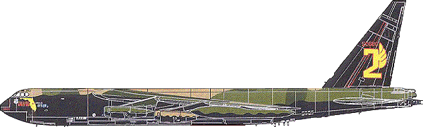

I have decided on a colour scheme for the model taken from an old aircraft book I had lying around in the workshop, see below :
B52D-25-BW 2nd AF's 7th Bomber Strategic wing name 'City of Fort Worth'

Another photo of the paint scheme
