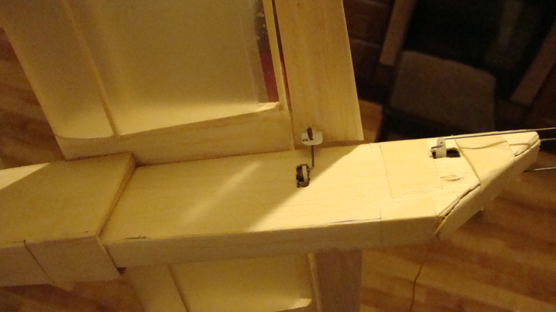

Very nicely done   :clap:  :clap:  . Would you have more photos of the fuselage. How are the wings attached?

« Reply #3 on: September 05, 2014, 00:25:34 AM »
Hi Jumbo,
             See pic of fuse underside (excuse the damage, had a little incident flying last night). Its basically 3 servos glued between 2 sheet sides of 1/16 balsa with a box up front to hold the battery. The carbon rod runs the full length of the fuse with a ply motor mount glued to the front. For the wing mount I sheeted the lower center section with 3/16 balsa from leading to trailing edge and did not cover this section. This then glues flat onto the fuse top after covering.
